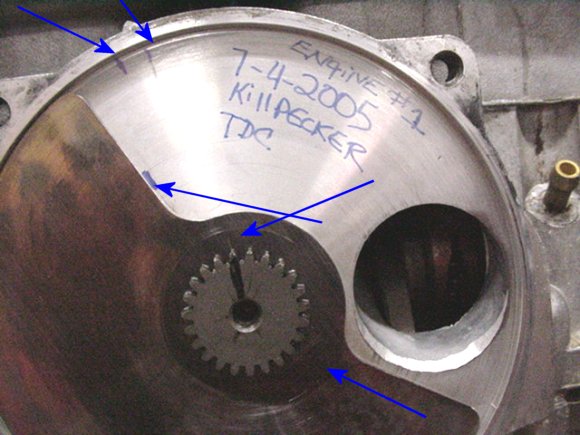

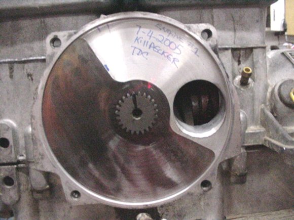

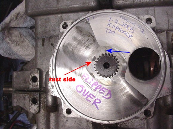

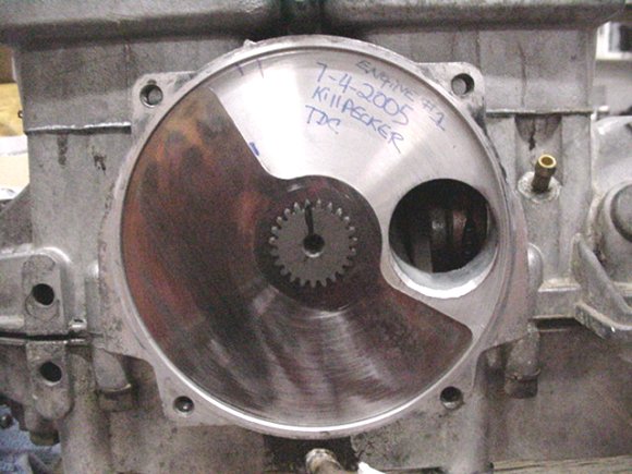

Here is as found tuning on 7-4-05 after killpecker trip![]()
have the Bosh ignition on my rotax 440 when looking at the flywheel end of the crankshaft what way do I move the pickup coils to retard the timing up or down? Retard by rotating clockwise.Advance by rotating counter-clockwise
