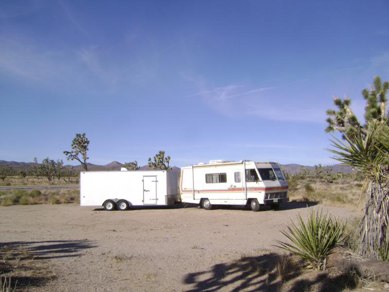

First trip 41 days 40 nights 6000 miles

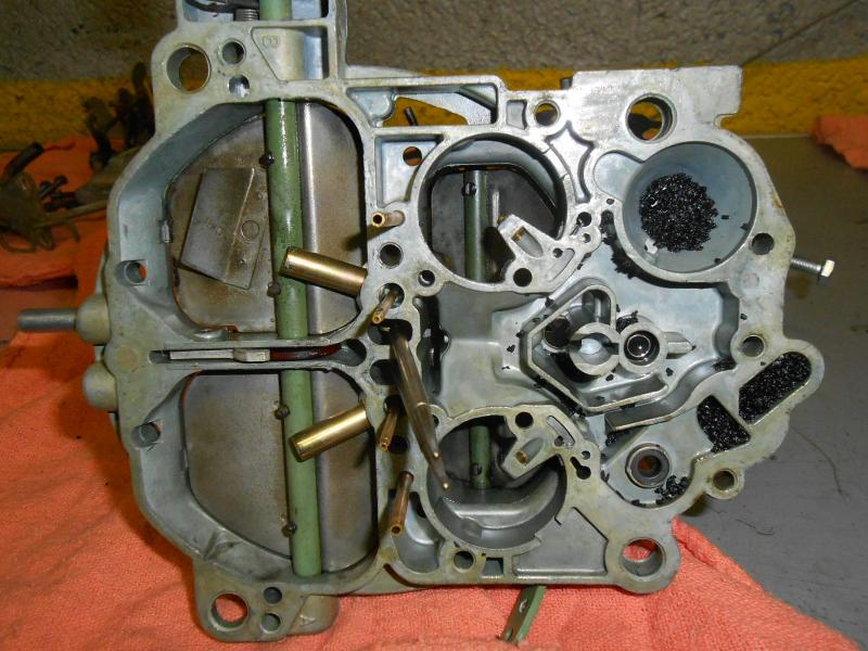

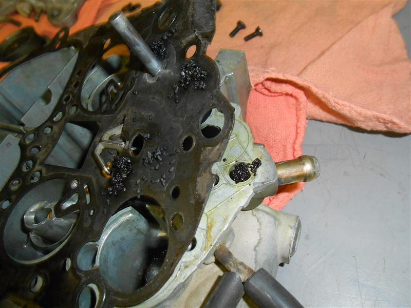

Well another trip west in the Ritz III this trip was not so uneventful at about the 2500 mile mark one of the valve cover gaskets started leaking turns out it was a cork gasket someone had been their before the other gasket was just all silicone sealer, not a big deal I stopped by Napa in Parker AZ bought new felpro gaskets then about 4 days later it rained so I used the rainy day to install them found the inside of the Engine new looking and no sludge build up actually found some raw rust inside where only a oil mist was hitting either someone did good maintenance on this Engine or it has been rebuilt or replaced before I seen no signs of the Engine been removed in the past, it only had 76k miles on it when I bought.
Stopped by a friends house that lives in Parker to see what he has going on he always has a project in his shop he asked how the RV was running told him great except for it was developing a hesitation on acceleration he went to his tool box got all the tools out I need to pull the carb said go pull the carb he would rebuild the accelerator pump was getting weak, so I pulled the carb and he rebuilt then I reinstalled and he adjusted everything and it ran perfect.
Fast forward to the trip home on my way to scpilot66's automotive shop in Albuquerque NM the Ritz started acting like it was running out of gas same old problem came back to haunt me it tries to vapor loc but only happens on warm days an at high altitudes like over 6000' elevation made it to Steves to pickup his blown Pilot Engine so I could take home and rebuild discovered a bad tire on the trailer so Steve got one from his local supplier and installed and I was on my way, got about 20 miles then it started to vapor loc again pulled over let it cool down for a few hrs then took off again made it another 15 miles started acting up again so I pulled into a truck stop for the night then next morning rerouted the gas line away from the after market exhaust system that was installed this seem to cure the vapor loc problem but it still ran like shit.
After a closer look discovered about 5 of the spark plug boots were burned up so I called Steve told him about my woes he dropped what he was doing got me a full tune up kit and brought it about the 35 miles East of Albuquerque and we tuned up the Ritz right their in the walmart parking lot, it ran better but STILL was not right we decided to nurse it back to his shop and go through the carb again, nursed it back and while pulling the carb discovered the problem the charcoal from the canister backed up into the vent of the carb filling the carb with charcoal Steve ordered a carb kit and rebuilt the carb working on it until midnight then we called it a day the next morning I reinstalled the carb then Steve dialed it in.

I am so glad this happen close to Steves shop I am for ever in his debt he saved my ass 2 times and rescued me, closed his auto shop to drive 35 miles on a remote service call I am for ever in his debt.

So how did it run after clearing out the carbon?

Talk about being in the right place at the right time. So what did you do with the canister?
Canister completely disconnected and port on carb capped, canister behind grill and in front of radiator will be removed and junked soon as the weather here permits.

Oh yes thanks to you ran great all the way home except for that slight hesitation at 3/4 to 7/8 throttle to WOT (Wide Open Throttle) I sent you the PM about will try the things you suggested on the next trip, almost like it has a lean spot its just a small dip and recovers almost instantly.

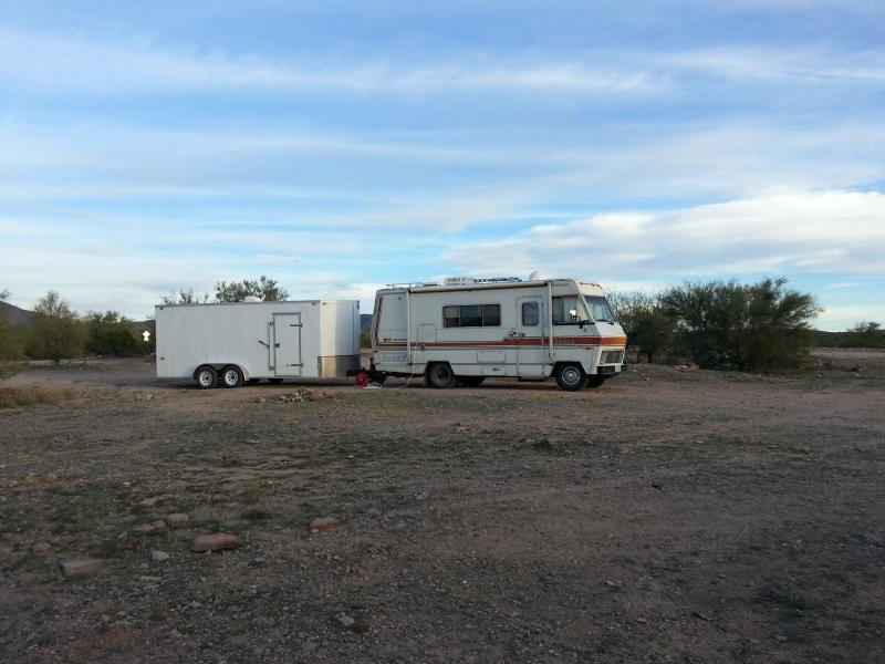

Another successful trip with the POS RV (still miss the bus) about 800 miles into the the 2015 fall trip the drivers side exhaust manifold started to leak making that annoying tick tick tick sound, will pull it and repair soon as weather is better here.
Noticed at higher elevations like in Flagstaff some cracking in the sidewalls of the rear tires will replace all 4 rears before next trip, this POS RV came with 7 new tires when I bought it so I know they are at least 5 years old, OR fairly new have no idea how many years old they were they had real good tread, anyways replaced the front tires (uneven wear) last fall, I have put about 24k miles on the RV so far as I am concerned the tires has earned their keep. Will rotate the fronts to the rear when I install new rears fronts has over 6k miles on them so they are reads for a rotate...
The generator used about a quart of oil on the trip, you can smell it burning oil in the exhaust but cant see smoke, has not fouled the plug yet, I noticed that the voltage is down a little also when under load, can see the 12 volts drop when using microwave, soon as the microwave turns off 12v goes back up to 12.8v verified that the AC volts drop to about 105V under load, also takes longer to heat food in microwave, when I bought the POS RV the seller claimed the generator "does not work" well its worked for me it now has over 1800 hours on it, I will pull the generator and assess its condition RIGHT NOW the plan is to replace the rings, quick hone on the cylinder, change the brushes (can see gold powder in windings indicating brush wear) I already bought brushes a few seasons ago. Quick and dirty rebuild get another 800 hrs out of it???
After all its a $1350.00 RV... I do have the generator our of the POS bus project I will install into this RV if the quick and dirty rebuild does not work out, the generator from the POS Bus sips the gas but the current generator runs so darn good hate to send it to an early grave.
The fan for the roof AC does not turn will investigate when weather is better, few years back had the same problem and it was the rubber mounts for the fan blower assembly were going bad and allowed the fan/blower assembly to sag and rub on the housing so it would not start, can remember how I fixed think it was a temp fix, never needed the AC on the last trip so not a big deal.
I have the like new AC from the POS Bus project I can install if current one is not worth fixing, I bet its the 35 year old rubber mounts.
Edit - Almost forgot.
On the way home after about a 10 hr drive I stopped at a rest area in NM to take a nap heard a strange whining sound traced it to the deep cycle battery in the battery box located under the steps of the RV, it felt HOT to the touch so I un-wired the battery and set the battery outside on the concrete didnt want a shorted battery catching fire while I was sleeping, the battery is dated 08/09 so its 6 years old I was told getting 24 months out of a deep cycle battery is good, pretty sure this was a battery removed from when I parted out the POS Bus project, the next morning the battery was cold so I put it in the trailer for the ride home it still had 10.5V when I got back home, I removed one of the two deep cycle batteries I have in the trailer (wired into the same system) and moved it to the battery box in the RV for the rest of the trip.
Before the next trip I will buy two of the 6 volt golf cart batteries I have read they last longer than deep cycle batteries do and are slightly more efficient for some reason.
