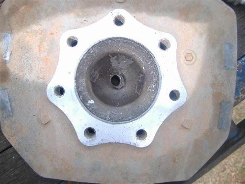

I can't tell if I was lean or not... I think my Engine went poof-kaboom because the plug threads in the head were stripped and my plug came loose allowing more air in???

I guess the stripped plug could allow it to suck air, have pics of the old piston?
PostPosted: Sun Aug 06, 2006 12:06 pm
Per your request...
PostPosted: Sun Aug 06, 2006 1:44 pm
That does not look good at all, a loose spark plug didn't cause that, any idea what happen?
What piston to cylinder clearance was this Engine setup for?
My guess is you exceeded the cycle life of the piston, without having the parts in my hand I would assume the piston was rocking excessively in the bore then the piston cracked, the cracks ran up to the wrist pin area (seen this before) then eventually let go, alot of people put extra piston to cylinder clearance when using a wiseco because they are scared they will sieze up.
Can you read the markings on the top of the piston to see what size it is?
Can you measure the current bore to see what size it is, knowing the as found piston to cylinder clearance would be helpful.
I would rebuild the whole bottom end including the rod, all the bearings have seen punishment they will not recover from.
I would ensure the new piston to cylinder clearance was correct and to the wiseco spec, not some shade tree mechanic spec. Wiseco has been building pistons for 40? years I would follow their advice...
Once you get this thing running again plan on doing routine inspections checking for cracks, at least once a year, I would not exceed 40 hrs run time, use the Honda gaskets if you can...
If your not going to rebuild yourself I would send it to Triple E 1-800-763-3762 Toll FREE Ed has been wrenching on 350's since they came out.
Good luck with a fresh Engine top and bottom you should enjoy that Engine for years to come, I would mount a 12v electric fan in front of the Engine so it has the 20 mph breeze on it at all times, you can split the distance in hieght so the head and cylinder both get plenty of air also drop back to 20:1 oil to gas ratio.

I am suggesting you check it about every 40 hrs, inspect it close for cracks and measure the wear as outlined in the service manual, the wear usually indicates when to change them, I have found 2 Pilot enignes ATVR worked on with HUGE piston to cylinder clearances one was .008 and the other was .010 I wouldn't let them bore my garbage can they clearly have indicated to me they have no clue, nobody in their right minds installs a piston with that much clearance, if they havent bored it yet I would send the cylinder to WISECO and have them bore it, its the piston rocking in the excessive clearances that hurts everything including power..
I have a feeling the guy doing the bore thinks that .004 clearance means .004 on each side of the piston so ends up with .008 clearance, .004 clearance means the finish hole should be .004 less than the biggest OD size found on the piston or .002 each side of the piston, I don't know what else they could be thinking that would make them install TWO TIMES the required clearance, if they ground the crank shaft on a car Engine with 2x the clearance all the rods would be knocking when you started it up.
