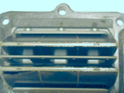

Here is another V-Force reed that is chipped this time not broke.
This is the second V-force reeds I have seen with a broken or chipped petal
not sure what happen to this one, someone found the picture on ebay

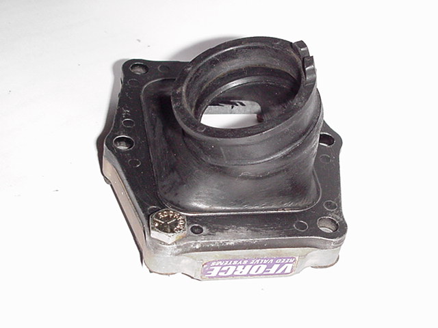

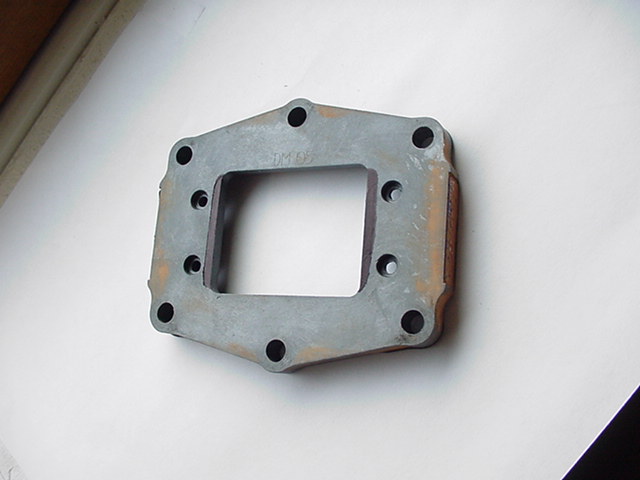

and sent it to me.Another cage for the 350, when you get a new one look at the
reeds from the side you can see air gaps.
The miss match is incredible for something that is suppose to be a performance part.

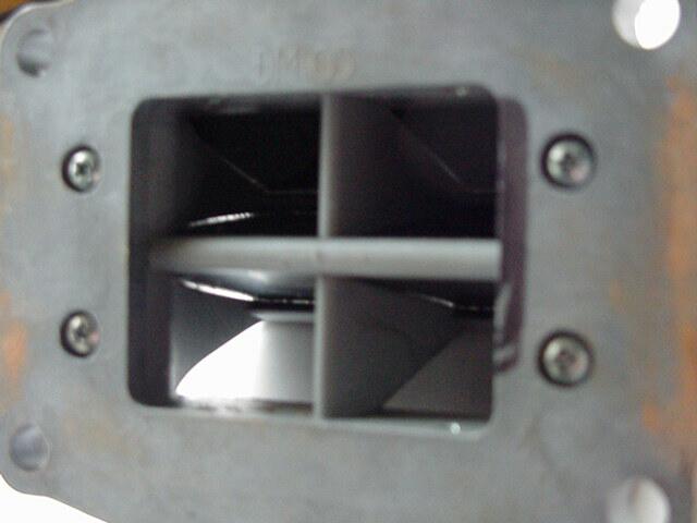

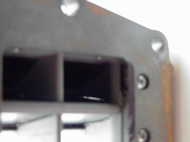

The black mark on the left is how much that needs removed to make it match
the material is no where thick enough to make it match correctly and your left with
too much angle and a compromise at best.I marked with a marker the material that would need removed.
