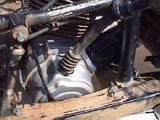

The stock "arm jerker" recoil starter. The Goki kit keeps the pull rope starter intact.

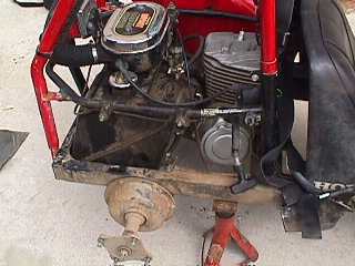

Second, remove the right side tire and fender. Then unbolt the engine off the engine bed.
You will need to be able to get to this side of the engine. Remove the carb. and spark plug wire. Don't forget the grounding wire.

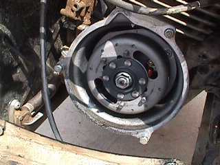

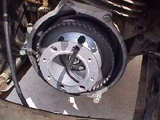

Next to come off is the starter pulley.
If you need to replace a coil or check the points (early years) now is the time.

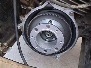

Set the Goki starter gear in place.
Install the spacer on top of the gear.
Tighten down with included hex wrench.
Bolt the starter pulley on to the spacer.

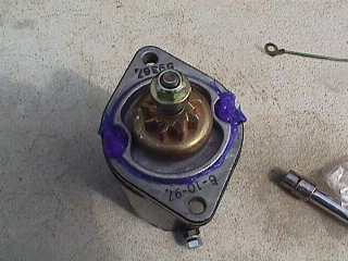

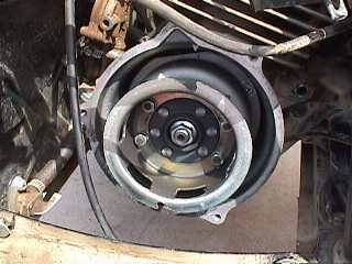

According to the manual, do not use a gasket between the engine and starter carrier. A small about of gasket maker gel is fine.
Using the longer supplied bolts, bolt the starter carrier and recoil starter on.
From left to right. engine, starter carrier, recoil starter.

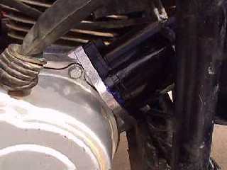

The starter. I added a little gasket maker gel around the edge for better water resistance.

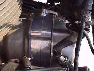

The starter bolted on. Make sure you bolt it on with the terminal facing up.
The engine bolted back it. Yes, it all fits. Just barely.

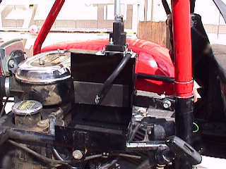

The battery box mounted, with the starter solenoid screwed on top. I would like this mounted in a better place, but I can't find one.
