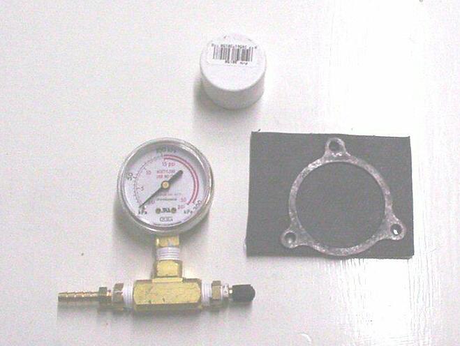

With those items removed it's time to pressure test the motor, In the picture below you will
see my home made pressure tester, It consist of a few fittings, gauge, blank off for the exhaust
and a plug for the intake. Total cost to make the tester was about 10 bucks, Before I always used
my compression tester in the spark plug hole and a bunch of adapters that was too much of a pain
so I made this simple and compact model, I will keep the old setup for motors without a vacuum
port.  MORE ON PRESSURE TESTING HERE
The blank off plate is just a piece of 3/16" aluminium plate with a rubber gasket, The old manifold
gasket was used as a template to drill the holes. A 1" PVC cap fit's real nice in the intake boot.

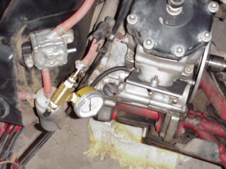

Above you will see the exhaust blanked off and the pressure tester installed in the vacuum line that goes to
the fuel pump.
With everything blocked off and tester installed it's now time to pressure test the motor. I start by putting
10 pounds of air in my portable air tank, That way there is no chance of putting too much pressure in the
motor, After it is under pressure I will spray down the motor with soap and water and watch the gauge.
Ok the motor held 10 pounds for 30 minutes and no bubbles appeared in the coolant or around the motor
so now it's time to drain the coolant and clean up the motor and start taking it apart.

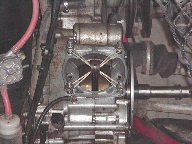

With the cylinder, head and pistion removed I put rubber bands through the rod and attach them
to the cylinder studs, This keeps the rod from being damaged, You can even pull the pull starter
and watch it go up and down.

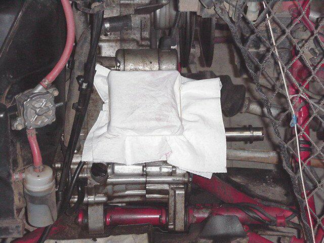

After the rod is secured I cover it with paper towels and put another rubber band around the studs
to keep the dirt out.
