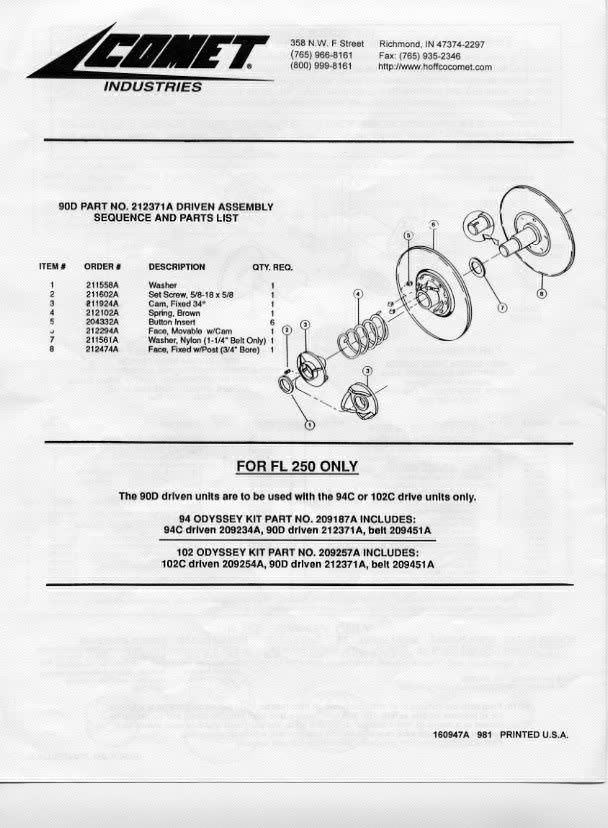

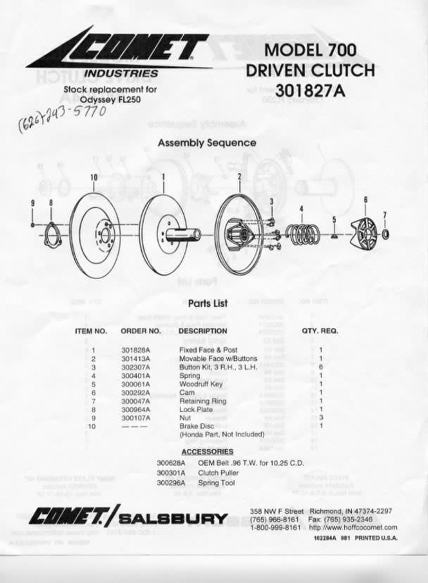

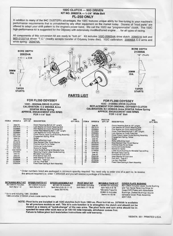

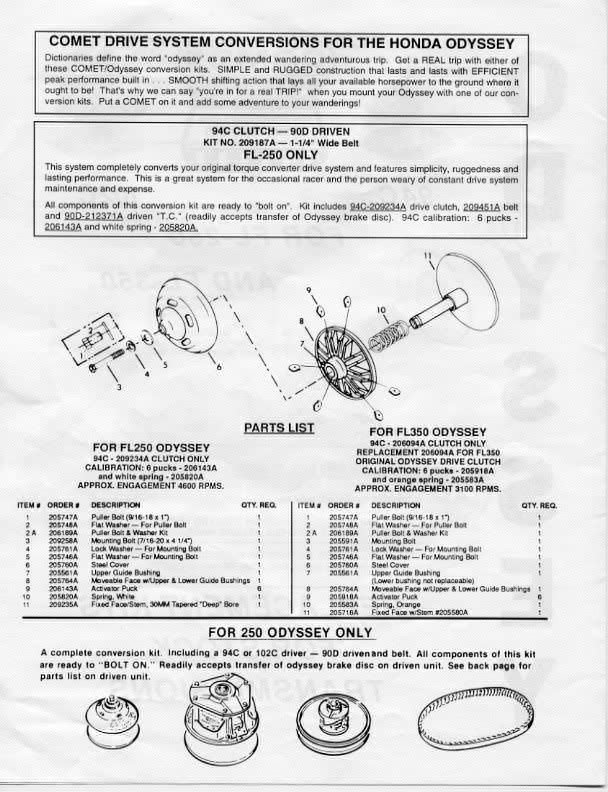

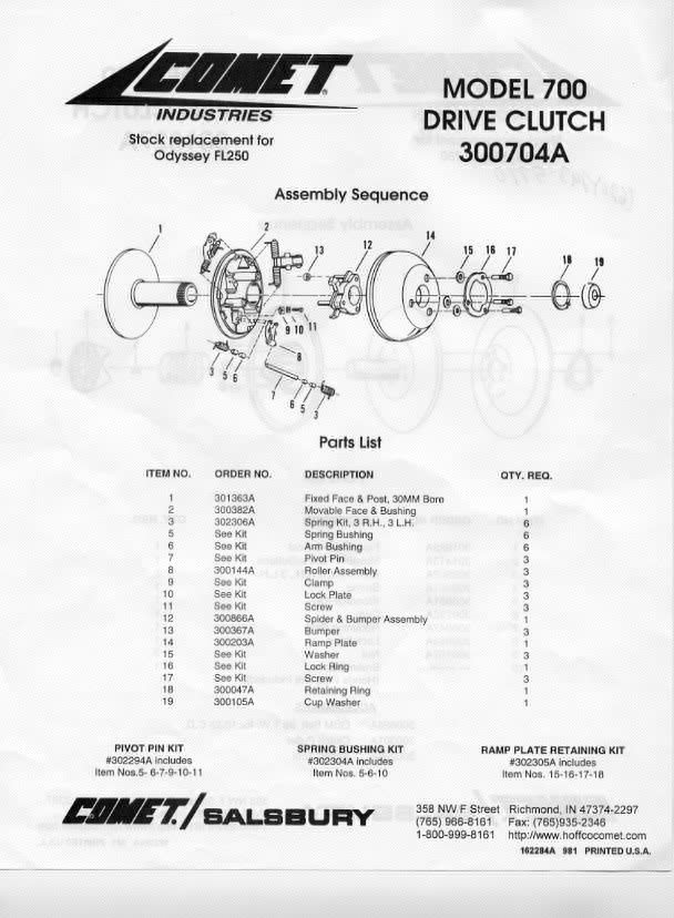

The Comet clutch info was scanned full size so if you need part #'s, just open the pic in an image editor and zoom in.
