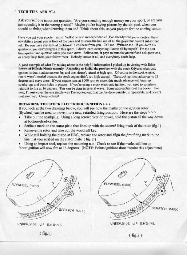

Unless you are using an aftermarket ignition system, the timing needs to be changed on the models with CDI ignition for better performance at high RPM.  You will lose some midrange pull but top-end will be much better and your engine will live to thank you.  Here is how to change the timing to 16 degrees BTDC.  (NOTE: The timing does not need to be changed on the models with points ignition)
With the stator and flywheel on, push the piston to BDC with a dowel or screwdriver and hold it there. Scratch a mark on the stator that lines up with the second firing mark. (There are three marks on the stock flywheel. One marked "T" for TDC and two more. The one you want to scratch a line beside now is the one closest to the "T".) Remove the stator and slot the holes about 8mm longer to the left when viewed from the top. (doing this lets you rotate the stator clockwise.) Put the stator back in and turn it roughly 6 degrees but don't tighten the screws, you need to be able to rotate the stator. Install the flywheel and key. Push the piston to BDC and hold it, turning the stator until the mark you just made lines up with the first firing mark (The one furthest from the "T" mark.) Now remove the flywheel and tighten the stator screws. Install the flywheel and key and torque the flywheel nut. Once more, push the piston to BDC and check to be sure that the mark furthest from "T" still lines up with your scribed mark. Now you can run your engine at much higher rpm's with less chance of detonation and longer over-rev.
You can also do it per this paper but without the flywheel key, your ignition timing may spontaneously change.
